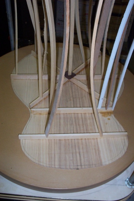

...since I last posted here, but I read frequently and the thread about x-braced backs has inspired me in my current build.
So, lets do one of those "Whats on your workbench" threads. They always inspire me .
I'll start by showing pics of my two current builds, one is a cocobolo/red spruce OM/GC-ish guitar and one is a 00 with fourpiece braz/red spruce.
OM
00

Welcome back, Lars!
And holy cow, thanks for this picture:
Now that's inspiring. What clean work.

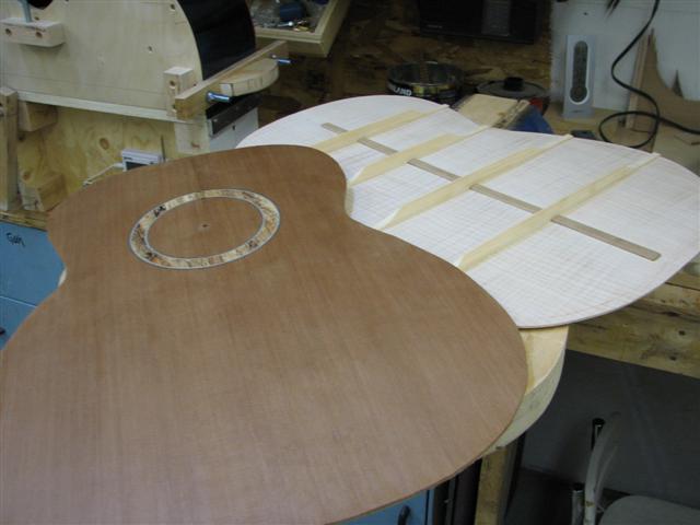

I'm working on a curly maple OM with cedar top.
Here are some pics of the progress.
Top and Back

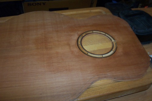

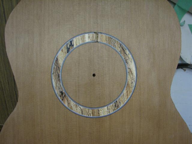

Rosette, spalted maple with double w/b purfling inside and outside.

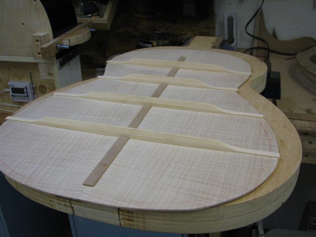

Back braced up and ready to attach to the body (not as clean as Lance, but I'm getting there.

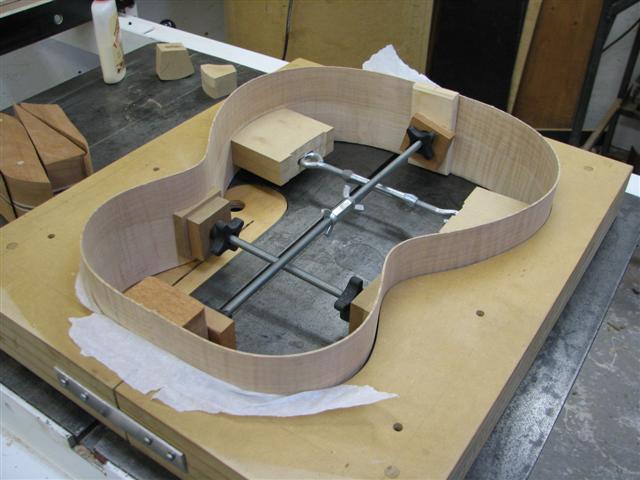

And the body with head and tail block glued in, ready to profile and line.

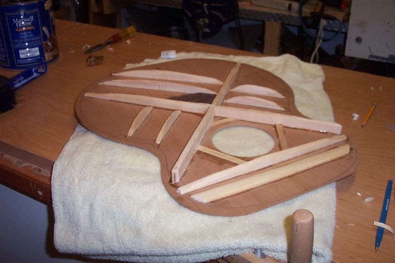

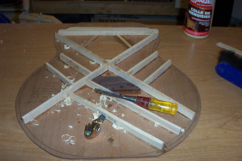

Okie dokie Lars, here's what i've been working on lately!
OLF SJ (Michael Payne's plans)
white ash back/sides with redcedar top and ebony bindings
braces being glurd on the back and carving the braces on the top

An Rod, that is a REALLY nice combo, I bet its gonna sound great. Can we see that top bracing?
PostPosted: Wed Nov 22, 2006 7:13 am
Ya, when I get to it later this weekend for sure.
I'm hoping it's going to sound good too.
PostPosted: Wed Nov 22, 2006 4:35 pm
[QUOTE=Lars Rasmussen] Nice guys! Serge is that HHG? Hey Carlton, you can do it![/QUOTE]
Yup, i admit being a bit sloppy at times but...iwas trying to catch up on Alain and... well, i cleaned it up afterwards!
PostPosted: Thu Nov 23, 2006 7:51 am
That is shaping up to be one incredible geetar - keep up the good work - PS love that bracing - looks very nice.

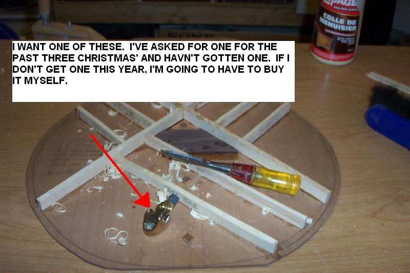

PostPosted: Fri Nov 24, 2006 9:12 am
Rod, you jealous huh huh?
Ok, next time i call you home, you let me talk to your wife, Bears have their way with Ladies!
